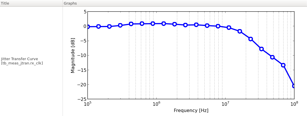

tb_meas_jtran : A testbench for measuring the jitter transfer function of a CDR
This testbench measures the jitter transfer characteristics of a clock-and-data recovery unit (CDR). The testbench measures the jitter transfer function at each frequency by applying a sinusoidal jitter to the input clock using a clk_gen primitive and measuring the magnitude and phase of the resulting sinusoidal response in the recovered clock phase. The jtran.py script repeats this measurement while sweeping the sinusoidal jitter frequency and constructs the overall jitter transfer function of the CDR.

Simulation Results
Figure. jitter transfer function of the CDR.
