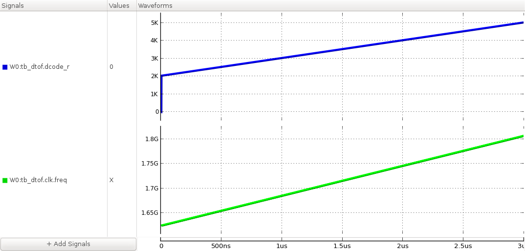

tb_dtof : A testbench for measuring the digital-to-frequency characteristic of a DCO
This testbench measures the digital-to-frequency (D-to-f) characteristic of a DCO by applying a gradually-varying digital input to the DCO and measuring its output frequency.
The measured frequency is expected to change with the digital input code according to the D-to-f equation assumed by the DCO model.
`include "xmodel.h"
module tb_dtof ();
    bit  [11:0] dcode;      // DCO digital code
    bit  [11:0] inc;        // incremental step
    xbit clk;               // clock signal
    real dcode_r;           // output digital code
    // dcode generator
    initial begin
        dcode = 14'b100000000000;
        inc = 14'b000000000001;
        while (dcode < 14'b111000000000) begin
            #(1e-9/`TIME_SCALE);
            dcode = dcode + inc;
        end
        $finish;
    end
    always @(dcode) dcode_r = real'(dcode);
    // DUT (device-under-test)
    OSC_DCO  DUT(.in(dcode), .out(clk));
    // probing
    probe_real  prb_in(dcode_r);
    probe_freq  prb_freq_lin(clk);
endmodule
Simulation Results
the D-to-f characteristic of the DCO
Figure. the D-to-f characteristic of the DCO.
