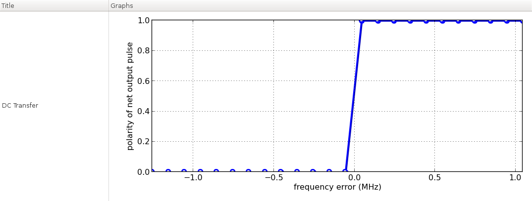

tb_meas_tfdc_freq : A testbench for measuring the frequency error vs. net output polarity transfer characteristics of a phase-frequency detector (PFD)
This testbench measures the frequency error vs. net output polarity transfer characteristics of a phase-frequency detector (PFD). The testbench utilizes a probe_dc primitive to sweep the frequency error between the two input clocks to the PFD and plot the resulting net output polarity.
data='/asset/modelbox/PDC_BinaryPFD/tb_meas_tfdc_freq.svg' type='image/svg+xml' class='modelbox-svg'
Simulation Results
Figure. frequency error vs. net output polarity transfer characteristics.
