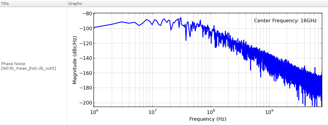

tb_meas_jhist : A testbench for measuring the jitter histogram of a PLL output clock
This testbench measures the jitter histogram and phase noise spectrum of the output clock of a phase-locked loop (PLL). The testbench first lets the PLL acquire a lock by applying a fixed-frequency clock input and waiting for the PLL responses to settle. Then it collects the output clock transitions and analyzes the jitter histogram and phase noise spectrum. The jitter histogram shows the probability density function of the clock edge position and the phase noise spectrum shows the frequency content of the jitter or phase noise. The jitter and phase noise of a PLL output clock can be contributed by the noise from the input clock and internal components.
`include "xmodel.h"
module tb_meas_jhist();
    parameter real freq_ref = 2.0e9;    // reference clock frequency
    parameter real RJ_rms = 10e-12;     // reference clock random jitter (RMS)
    parameter real t_lock = 200e-9;     // time required for PLL to lock
    xbit clk_ref;                       // reference clock
    xbit [7:0] clk_out;                 // output clock
    xbit clk_out0;                      // alias for clk_out0
    // DUT phase-locked loop
    PLL_ChargePumpPLL  DUT(.in(clk_ref), .out(clk_out));
    // reference clock generator
    clk_gen     #(.freq(freq_ref), .RJ_rms(RJ_rms))
                clk_gen(clk_ref);
    // probing
    assign clk_out0 = clk_out[0];
    probe_xbit  #(.start(t_lock)) probe_out(clk_out0);
endmodule
Simulation Results
jitter histogram of PLL output clock
Figure. jitter histogram of PLL output clock.
phase noise spectrum of PLL output clock
Figure. phase noise spectrum of PLL output clock.

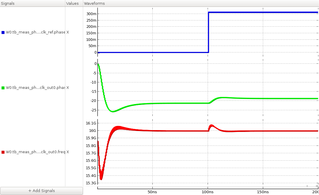

tb_meas_phasestep : A testbench for measuring the phase step response of a PLL
This testbench measures the response of a PLL to a step change in its input clock phase. Once the PLL acquires a lock, the testbench applies a step change in its input clock phase using the step_gen and phase_to_clk primitives. The responses in the output clock frequency and phase indicate the loop bandwidth and stability of the PLL.
`include "xmodel.h"
module tb_meas_phasestep();
    parameter real freq_ref = 2.0e9;        // reference frequency
    parameter real phase_step = 0.1*M_PI;   // phase step amount
    parameter real step_delay = 100e-9;     // phase step delay
    xreal phase_ref;                        // reference phase
    // phase step generator
    step_gen        #(.init_value(0.0), .change(phase_step), .delay(step_delay))
                    phase_gen(phase_ref);
    phase_to_clk    #(.freq(freq_ref)) clk_gen(.in(phase_ref), .out(clk_ref));
    // probing
    initial begin
        $xmodel_dumpfile();
        $xmodel_dumpvars("level=", 2);
    end
    probe_freq      fq_out(clk_out0);
    probe_phase     #(.freq(freq_ref*8), .phase_wrap(0)) ph_out(clk_out0);
    probe_phase     #(.freq(freq_ref)) ph_ref(clk_ref);
endmodule
Simulation Results
phase step response of the PLL
Figure. phase step response of the PLL.
