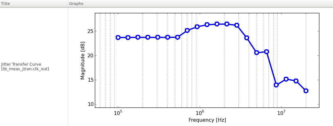

tb_meas_jtran : A testbench for measuring the jitter transfer characteristics of a PLL
This testbench measures the jitter transfer characteristics of a phase-locked loop (PLL). The testbench measures the jitter transfer function at each frequency by applying a sinusoidal jitter to the input clock using a clk_gen primitive and measuring the magnitude and phase of the resulting sinusoidal response in the output clock phase. The jtran.py script repeats this measurement while sweeping the sinusoidal jitter frequency and constructs the overall jitter transfer function of the PLL.
`include "xmodel.h"
module tb_meas_jtran();
    parameter real ref_freq = @ref_freq;    // input clock frequency
    parameter real SJ_amp = @sj_amp;        // input sinusoidal jitter amplitude in UI
    parameter real SJ_freq = @sj_freq;      // input sinusoidal jitter frequency in Hz
    parameter real t_lock = @t_lock;        // initial simulation time (PLL locking time)
    // variables
    xbit clk_ref;                           // reference clock
    xbit clk_out;                           // output clock
    bit reset;
    // reference clock generator with sinusoidal jitter
    clk_gen         #(.freq(ref_freq), .SJ_amp(SJ_amp), .SJ_freq(SJ_freq))
                    clk_gen(clk_ref);
    // reset
    initial begin
        reset = 1;
        #(10e-9/`TIME_SCALE) reset = 0;
    end
    // DUT (device-under-test) digital PLL
    PLL_DigitalPLL  DUT(.in(clk_ref), .out(clk_out), .reset(reset));
    // probing
    probe_phase     #(.freq(16*ref_freq), .start(t_lock)) probe_phase(clk_out);
endmodule
Simulation Results
Figure. jitter transfer function of the PLL.
